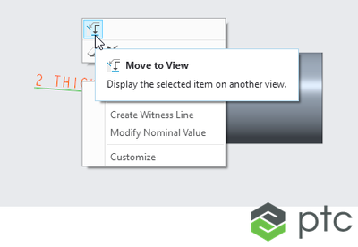

Hi ,
In Creo 4.0  M140 , there is command called "Move to view " which is used to move an annotation from one view to another view , I have do this using API & I m using ProToolkit , Please help me out with solution
Kunal

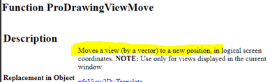

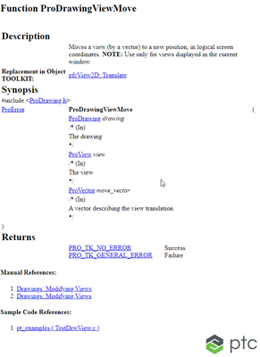

Your application needs to perform the equivalent of RMB on a Drawing view > Move to View. This is a typical instance where a dedicated function exists.
When you search the API documentation with *viewmove" you will find
ProDrawingViewMove
and bonus: pt_examples will give you some code.
KB_9753804
(To:remy)
This API is used to position view not to move annotation from one view to another
Kunal Bidkar
remy
(To:KB_9753804)
That's partially right: this function enables to move a Drawing Note to a different view.  This is my understanding of the topic : "How to Move a drawing Note From one view To Another".

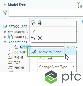

Can you share a screencapture of the operation that you need to run with toolkit? or share some model (even a dumb one)?
By chance do you mean the RMB > Move to plane operation?

You are right the command you referred to is Move to View when RMB a drawing dimension for example:
To get an actual function to perform the equivalent, an enhancement request is required.
Else follow @FabianWolf suggestion.
