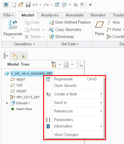

I would like to add a menu to the red area of the attached picture

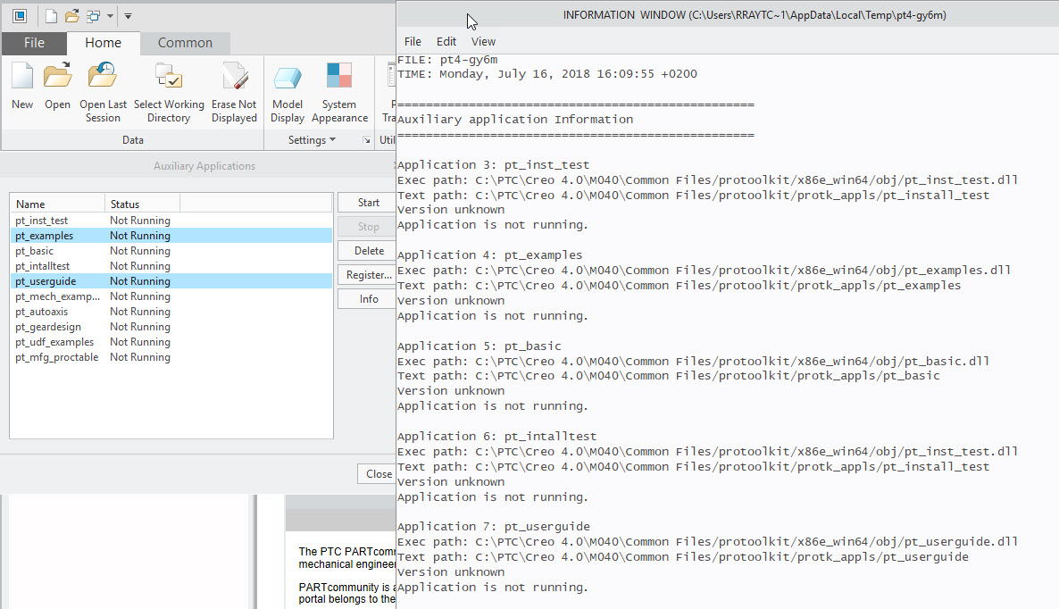

For example in the pt_user guide there is such menu item defined for part mode:
So means first you need to start the ptc examples / - here it is only the ptc user guide

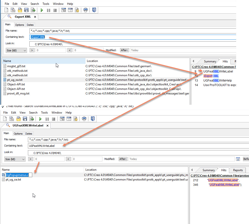

So the next question is how to find the sourece of the desired function.
We see here the menu text is  -ExportXML.  So search for this text / string in the Toolkit installation directory

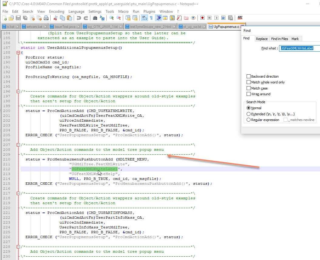

So there I found the UgPopupmenus.c as top point of the implementation (from there we need to check the further implementations of the subroutines and help libraries

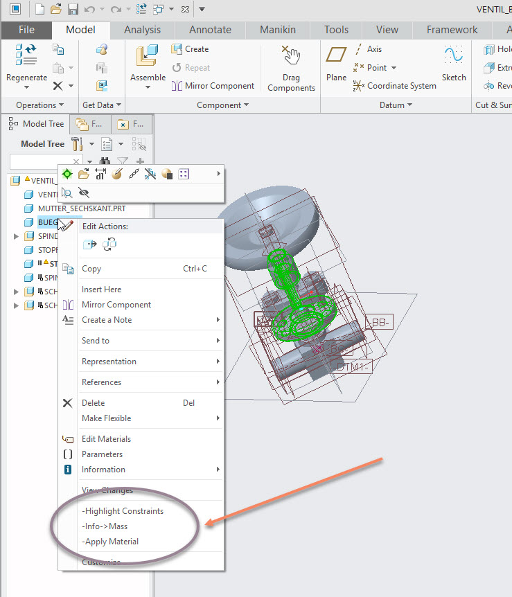

You can additionaly try to find the implementation of the following menu items (in picture)
