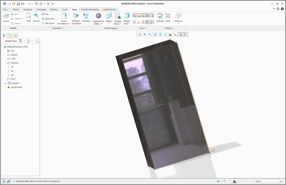

I have would like to assign a spesific photolux color (adv-steel) for my .mtl file but the color won't show up in the model.

I followed below mentioned steps.
  • start CR3 M120
  • open heinopalikka.prt
  • remove all materials from the model
  • save model
  • exit CR3 M120
  • I do not have PRO_MATERIAL_DIR option defined in config.pro
  • CR3 M120 installation directory ... E:\PTC\Creo3_M120
  • I created bfacj.mtl file in E:\PTC\Creo3_M120\Creo 3.0\M120\Common Files\text\materials-library directory ... I copied its contents from your original post
  • I modified global.dmt file in E:\PTC\Creo3_M120\Creo 3.0\M120\Common Files\graphic-library\appearances directory ... I added adv-steel color at the end of file (55 lines copied from your global.dmt file)
  • start CR3 M120
  • add and assign bfacj material
  • finished

insert the definition of adv-steel color into global.dmt file and ... you are done.

AWESOME!
My problem is solved.
I think that the problem occured beacuse I had not created bfacj.mtl file in E:\PTC\Creo3_M120\Creo 3.0\M120\Common Files\text\materials-library directory. Now all the colors are correct. This saved my day!

I tested assigning .mtl file color inCreo 3.0, M110 with success.
In my E:\PTC\Creo3_M110\Creo 3.0\M110\Common Files\graphic-library\appearances\global.dmt file there is gold_ptc color. No ptc_gold color is present.
I attached bronze_mh.mtl file I used during testing.
If I changed color name in bronze_mh.mtl file to non-existing color name (I edited file in Notepad++), created new part and assigned material ... I get white colored model.
