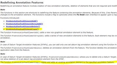

FV
(To:JB_87049)
JB_87049
(To:FV)
Thank you for your reply.
I tried that already. There is one small problem with this suggestion, namely a "driven dimension" annotation is NOT an annotation element (a "driving dimension" annotation is) hence it won't be accepted by the suggested function. I've now circumvented this problem by using mapkeys.
FV
(To:JB_87049)
AFAIK, ProAnnotationfeatElementCopy(...) works as expected - it takes ProSelection constructed from a ProFeature. the feature has to have PRO_FEAT_ANNOTATION as ProFeattype. This function will create a copy of the driven or ref dimension in the target annotation feature. The original driven dimension would stay as it was and could be deleted if needs to be.
ProAnnotationElem of a driven dimension which has a ProSolid owner is accessed via ProSolidAnnotationelemsVisit(...)
JB_87049
(To:FV)
The problem in my case is that the driven dimensions are considered as bad inputs.
The only reason I could come up with to explain this behaviour is that this is caused by the fact these driven dimensions are not recognised as annotation elements. I have verified this in my code.
Strangely enough if you do the conversion to an annotation feature manually in Creo it works.
So I have now solved my problem by embedding a mapkey into my toolkit code.
