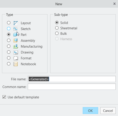

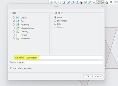

With current configuration CAD Objects are creates e.g. PRT002.PRT as shown below :

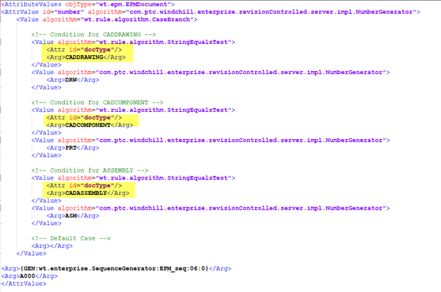

I already can create CAD object as per my define OIR as below :

OIR screenshot :

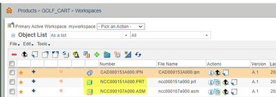

1. When CAD objects are created via WGM/WEB browser workspace or "New CAD Document" button in Creo,
I am able to get the same numbering as per OIR even if I use <Attr id="docType"/> :
Workspace screenshot :
2. When I create CAD object using "File >> New" in Creo, I am unable to get respective OIR logic f I use doc: <Attr id="docType"/> .
New button window in Creo
