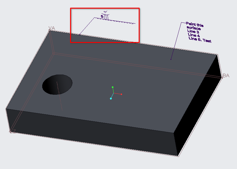

I'm trying to figure out how to get the name (and other data if possible) of a 3D symbol like the one marked with a red rectangle in the picture below. I'm using Creo 6.0.4.0 and toolkit.
Any help or advice is much appreciated.

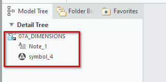

My bad, I finally found the function I needed to get the name of the annotation "ProModelitemNameGet".
