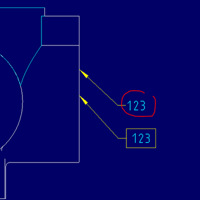

Hi Everyone, I‘m a newcomer in JLink, so I have occurred a lot of problems during developing, but there is a little problem which I have not idea how to fix. This problem is about making customize note with box in drawing, but I cannot make note success in a box with leader. Just see my code following:

Well, I got result with this code just see the picture, the note without box,
I do not know why , how to input text in JLink can CreO display note with box??

I didn't try running the code but, it seems like the '@' ']' '[' chars are being stripped and are not part of the text of the resulting note. Is that the case?
'@' is a unicode character.
Also see if the API allows for setting the text after the note is placed on the drawing. Doesn't look like the API is buggy, but it's worth a shot anyway.

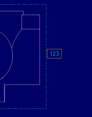

Hello James62, thanks for your reply! Just like you see, '@' ']' '[' chars are being stripped in text when I add note with leader, if I comment the code of leader attachment definition( the following code), all the chars can be displayed right, you can see the following picture.

James62
(To:robbiep)
Ok, it looks like a bug. I didn't try to reproduce it. Surely the J-Link API isn't perfect. If you can report it to PTC please do.
