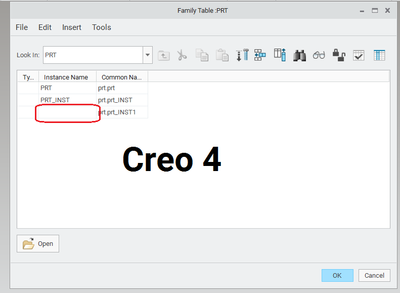

Instances Names don't show highlighted and pre-selected in the Family Table
MarcoMonteiro
In Creo 4 the items in the Family Table don't show highlighted and pre-selected.

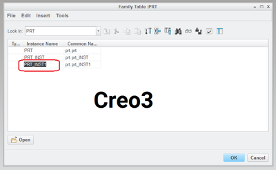

In Creo 3 the instance is highlighted and pre-selected.

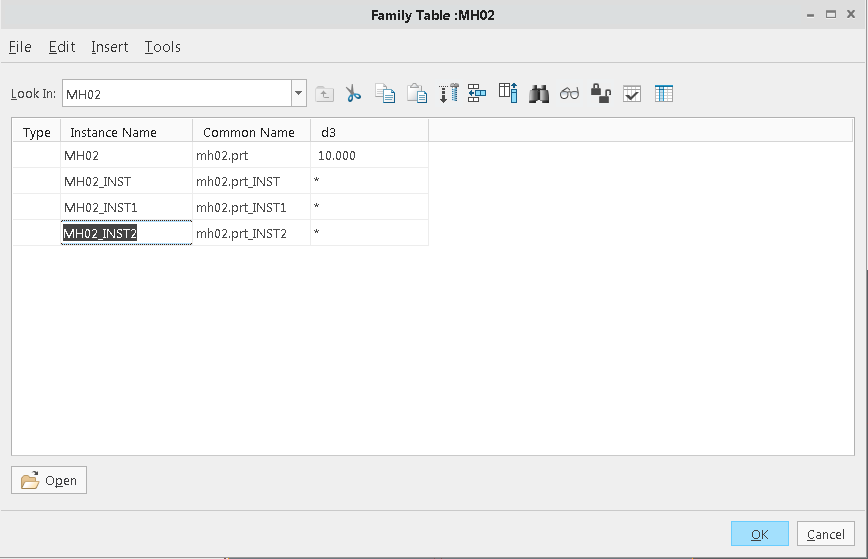

It was the command default_ui_font ROBOTO,8 in the config.pro.
I tried default_ui_font TIMES,8, didn´t work, but it works well with ARIAL style.
