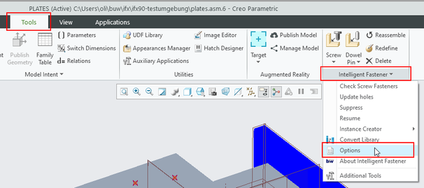

Just a question: where I can find the IFX option? There is no USE_ARCHIVE or PATH_ABS_ARCHIVES in my config.pro file
you find the IFX options under Tools > Intelligent Fastener > Options.
The Intelligent Fastener group is only available in assembly mode.
