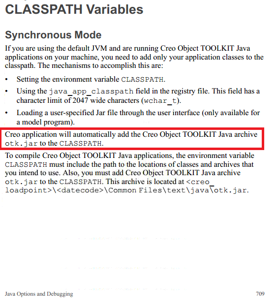

Creo adds CLASSPATH variable when it starts JLink application via protk.dat file.
It looks like user running JLink application must have Creo+JLink installed - see below.
PDF manual is attached.
