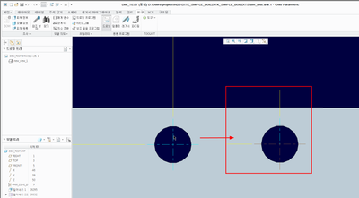

When creating a dimension in 2D, Creo highlights one direction of the axis.
When select axis via ProSelect(), Creo highlights all direction of the axis.
Is it possible to highlights one direction(at cursor) of the axis when select axis via ProSelect().?

When creating a dimension by selecting an axis and an edge, if the direction of the axis is selected incorrectly, the dimension is not created as intended.
Therefore, we hope to emphasize the direction of the axis to the user.
