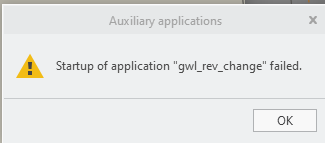

Have four j-link synchronize apps developed in creo 2. Went to Creo 6 from Creo 2. Recompiled using the OTK.jar with java 6. Worked with no problem. With Creo 8 they failed to start. Recompiled the apps with Java 8 with the OTK.jar from creo 8. Still does not work they fail to start. Compiled install_test this app will not start.. The config in the folder otk_java_appls\install_test has this config "regen_failure_handling resolve_mode" is this needed?
this config setting "jlink_java_command C:\Program Files\Java\jdk1.8.0_333\jre\bin\java.exe" does not seam to do anything. Do not have it in my Creo 6 and it works.

Porting from Creo 2.0 to Creo 6 was successful and your Creo 6 runtime failed to start with Creo 8. Despite recompiling with Creo 8, the application fails to start. install_test is indeed a benchmark in your instance and the test reveals that your instance of Creo 8 needs to be set.
Can you confirm that the error message you get is Startup of application "<Application Name>" failed ?
Thanks to your confirmation this will narrow down the investigation.
pgalens
(To:remy)
Yes I get this for my all my applications

with jlink_java_command set in the config the install_test app would register but fail to start. With my apps they register but when try to start they lock-up the Creo session. Auxiliary Applications (Not Responding) . Without the  jlink_java_command both would register but fail to start.
install_test is located in C:\Program Files\PTC\Creo 8.0.4.0\Common Files\otk_java_free\otk_java_appls\install_test
My apps are on a network drive (similar location as Creo6 which works)

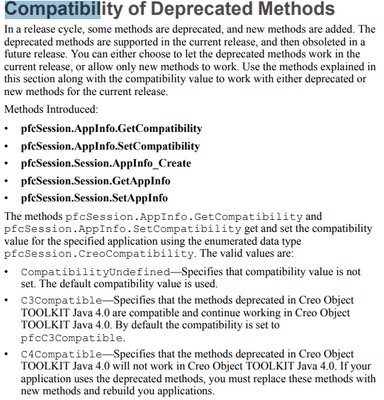

Have you tried messing with compatibility ?
pgalens
(To:sjuraj)
Should have looked into Otk_Java_RelNotes.pdf
Creo 8.0.0.0 requires the latest version of JAVA 11 installed on your machine.
I downloaded Java 11.. Will install and test.
