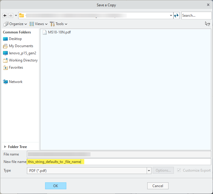

I do not think this is possible with mapkey functionality alone. Anything in the UI that requires a user to generate a string in the UI dialogue is not going to update automatically from a mapkey. One way to deal with this is have the mapkey call an external script that would rename the PDF file once saved using Windows OS functionality.
When using save as on a file you will get this dialogue and the default value is the current file name. The mapkey will record the mouse actions and keyboard entry in the field but mapkeys will not create a "variable" that will read from a parameter AFAIK.

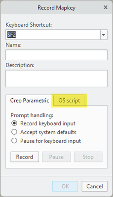

Mapkey operations include the ability to do the following actions:
Pause for user interaction.
Handle message window input more flexibly.
Run operating system scripts and commands. The Record Mapkey dialog box contains the OS Script tabbed page, whose options allow you to run OS commands instead of Creo Parametric commands.
