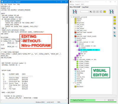

Just wanted to let you all know... the latest release of Nitro-PROGRAM has a NO HASSLE - FREE LICENSE option...
If you have ever struggled with seemingly never ending edit-import-fix-import-fix-import cycle of creating or editing Pro/PROGRAMs for Creo Parametric Parts or Assemblies... -OR- nearly screamed while trying to edit a Pro/PROGRAM that someone else created....
Then Nitro-PROGRAM is something you should download immediately and use!
Nitro-PROGRAM eliminates the pains and frustrations of the "text editor" and transforms the creating, editing and testing of Pro/PROGRAMs into a visual, drag-and-drop, editing love-fest by comparison.  😉

Nitro-PROGRAM saves time, reduces frustration, improves accuracy and enables you to think about the most important elements of Creo Parametric Automation -- data-flow and regeneration!
Simply Download, Unzip, Run.... and request a FREE License... NO REGISTRATION REQUIRED!

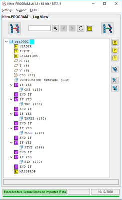

You can open any part/assembly which contain PRO/Program. Nitro-PROGRAM will display your PRO/Program nicely is its graphical editor. There's no limit in "extracting" the PRO/Program from your model into Nitro-PROGRAM.

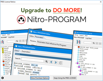

The free version is limited on the number of IF statements it can import back into your model.
The current limit is only 5 IF statements for the free version (but IF statements in the Relations do not count to this limit).
If you hit the limit, the free version of Nitro-PROGRAM will simply not import the (modified) PRO/Program back into the model. It will show a splashscreen (see below) and a message "Exceeded free-license limits on imported IF statements" in the Log View of Nitro-PROGRAM.

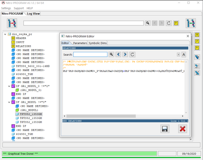

Please, check UTF support. Feature names in the tree and relations.
Language?!
can you send a model to test?!
dave
Language: Russian
Большое спасибо ... Я вижу ту же проблему. Мы посмотрим!
Dave
Nitro-PROGRAM is ENGLISH ONLY ... Sorry ... for some reason PTC chose to export Pro/PROGRAM content in native language for the installation...  And the parsing can't pick up on the language variants currently.

please can you reveal the exact limits implemented in the FREE version ?
My questions follow:
1.] How many features can a part have?
2.] How many features+components can an assembly have?
3.] What happens when the limit is exceeded?

From my own experience (testing Nitro-PROGRAM):
