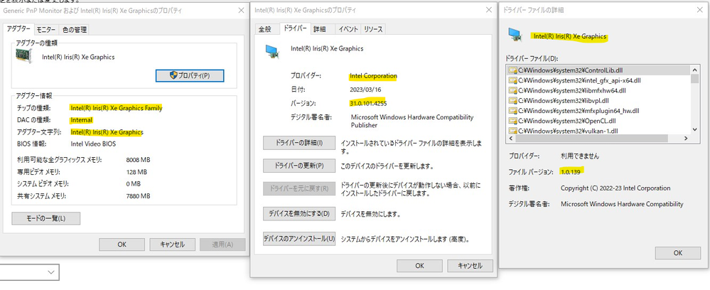

When you try to edit annotation text etc. in drafting, it is redrawn continuously, making it very difficult to use.
I would like to know if there is a way to prevent continuous redrawing using config etc.
this is caused by graphic card driver.
What graphic card is installed in your PC ?
What graphic card driver version is installed ?

I am using the following drivers.

download older/newer versions of driver, install it and test. Only this way you can resolve your problem.
Note: PTC does not support Intel graphic cards.
Thank you for your support.
This driver was latest version.
I’ve gave up this problem.
Thanks.
sometimes it is necessary to install older version of driver !
The newest version do not have to be the best one !
