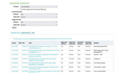

Hello, where can i find the release notes just for parametric.
For example, i have 10.0.3.0 and i want to see whats have changed in 10.0.6.0 or 11.0.2.0?
In search i could find it just for toolkits...
mkajdan
(To:OS_11014878)
I think Update Advisor is what you might be looking for to see bug fixes.
10 REPLIES 10

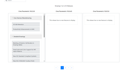

Login in to PTC.com
https://www.ptc.com/en/support
Click "What's New" on the bottom of the right hand side.
It brings you to the "What's New Tool" where you will fill in the boxes:
Dale_Rosema
(To:Dale_Rosema)
The at the bottom of the tool are pages for the additional releases if you type in 11.0.2.0 instead.

Thanks, but it seems strange to me that the Version 10.0.4/5 should be the same as 10.0.3.0.
It´s just about the features but not the bugfixes.
Guess there is no list about the bugfixes?
mkajdan
(To:OS_11014878)
