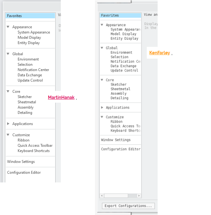

following picture shows that your Creo uses non-default font in UI. Maybe your config.pro contains DEFAULT_UI_FONT option.

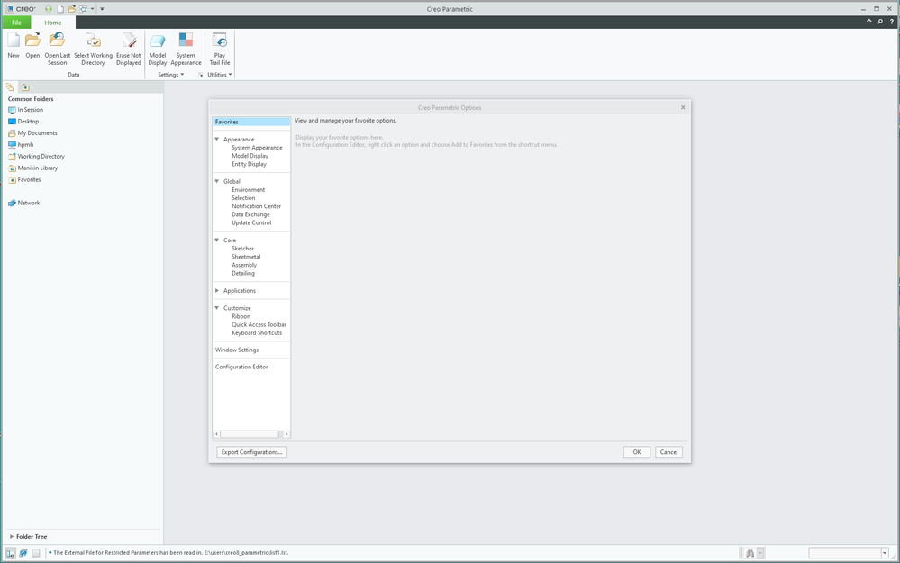

My Creo 9.0.2.0 pictures follow ...
Martin Hanák
Aha. So not a custom font, but not the default font. I switched to a monospaced font because I do a lot of relations stuff and the default font is terrible if you're trying to keep things lined up, want your code to be "nice", etc. Also, I like to be able to easily tell the difference between zero and capital O, between 1, l, and i, and other characters that are somewhat ambiguous. Commenting out the default_ui_font line in my config.pro does in fact make the options window a "normal" size. But, the default font, to me, isn't desirable. So, I'm forced to live with the options window being an oversized annoyance.
