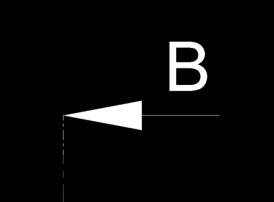

please see attached pictures - first ist the standard output I get in Creo (picture 1) but I want to have the letter in line with the section line by default and also the section line should by longer by default (picture 2)
Is this possible via a config setting?
- by standard not to move always manually the letter.
Is this possible with some config settings?

examine the values of the crossec_text_place detail option.
