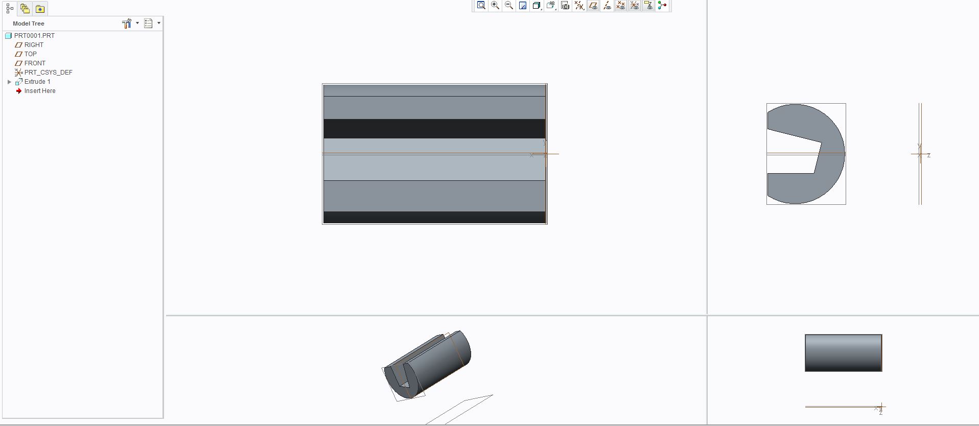

If the i have understood your question correctly, the attached image shows what you are currently using.
If so, you can create a Trail file to turn the split screen option on or off and create a map key with keyboard shortcut to run this trail file. Below is what is use for Creo 2.0.
Split screen on:
!trail file version No. 1600
!Creo  TM  2.0  (c) 2018 by PTC Inc.  All Rights Reserved.
~ Command `ProCmdWinSplit` 1;
Split screen off:
~ Command `ProCmdWinSplit` 0;
