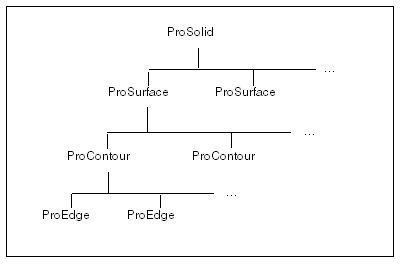

Toolkit C also have these methods but with different name in Core: 3D Geomentry chapter, for the connection issue of showing the Website of community i can't post you the image, you can find it yourself
Sorry for the later answer, you can find the Hierarchy of Geometrical Items in a Part in the chapter Core: 3D Geometry, the sturcture like below image
