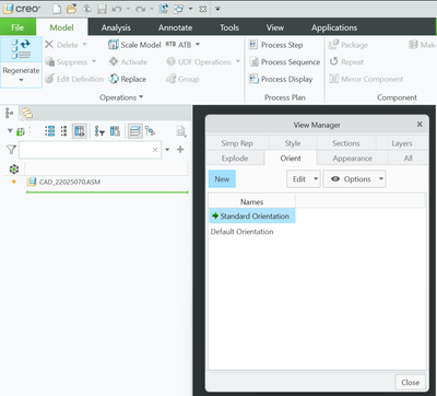

Hi there,
is there a way to declare a template for process plan assemblies?
When I try to create one, "use template" is grayed out:
The main problem is, that there are no pre-defined orientations, which makes it unnecessary inconvenient to create drawing from that later.
I am using Creo 10.0.7.0

Consider making a mapkey called "Process Template" and have it prompt to create a new assembly and then add the necessary custom parameters/views.  In cases like this when there's very little chance for intervention from PTC, working around the issue with a trail file or mapkey is often the most efficient solution.
In my job, we often receive models from outside vendors or from colleagues in different organizations. I've created mapkeys to add our custom parameters, layers, pre-defined views, and simplified reps to update those models to comply with our standards. It seems like such a thing would help in this case. I'[m sorry there's not a more elegant solution.
