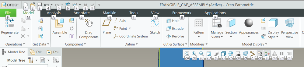

The ribbon is mapped extensively to keystrokes already. If you press the ALT key it will display the mnemonics for ribbon commands that are available by default. You can use these shortcuts when recording mapkeys. See the labels below (assembly mode).
For example, in part mode: Extrude using keyboard shortcuts is invoked using ALT->m->x  .

Oh cool! I didn't know you had to hit "M" before the X because it's in the model window. I feel like hitting 3 different keys is still kind of clunky, but I think I can make it work. Thank you!

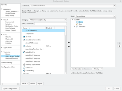

Click on "File", then "Options" and this menu pops up.
Click on "Quick Access Toolbar" and as you scroll, you can see any Shortcut that are put there by PTC.
