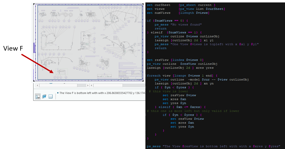

RPN
(To:RPN)
For me it does look good, test with a couple of views  🙂
set curSheet	[ps_sheet current ]
set views		[ps_view list $curSheet]
set numViews	[llength $views]
if {$numViews == 0} {
	ps_mess "No views found"
	return
} elseif  {$numViews == 1} {
	ps_view outline $views outLineObj
	lassign [outLineObj 2d ] x1 y1
	ps_mess "One View $views is topleft with x $x1 y $y1"
	return
set resView [lindex $views 0]
ps_view outline  $resView outLineObj
lassign [outLineObj 2d ] xres yres
foreach view [lrange $views 1 end] {
	ps_view outline $view outLineObj
	lassign [outLineObj 2d_values ] xn yn
	if { $yn < $yres } {
 # this view is lower
		set resView $view
		set xres $xn
		set yres $yn
	} elseif { $xn <= $xres} {
# this one is more left but only valid if lower
			set resView $view
			set xres $xn
			set yres $yn
ps_mess "The View $resView is bottom left with with x $xres y $yres"
