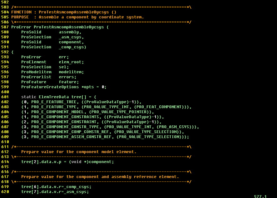

FV
(To:rgorny)
there is a sample code in protk_appls\pt_examples\pt_asm\TestAsm.c in protoolkit installation folder. Probably this is what you are looking for...
