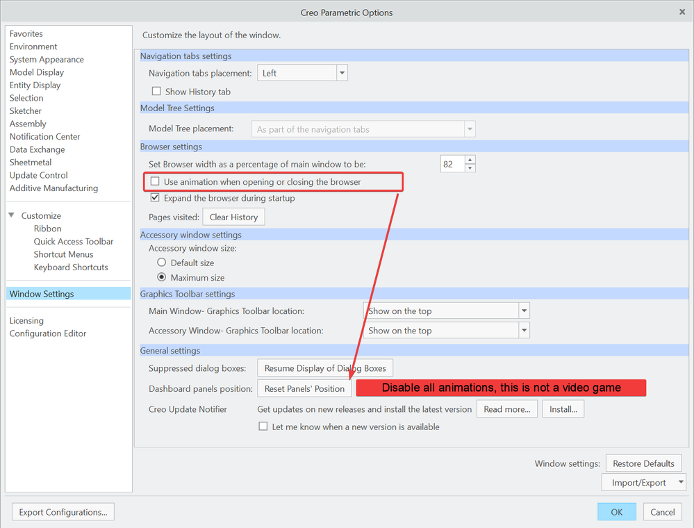

Since upgrading to CREO 6, the Dimension text pop-out window defaults to ALWAYS dislocate itself and start floating.
This is incredibly annoying for many reasons, and I see that others have similar issues.
Using Mapkeys to tell the window to REATTACH will cause CREO to crash 9/10 times.
I have resorted to always clicking the reattach manually, and even that causes crashes 4/10 times. Obviously just the worst when trying to detail a large drawing package.
Is there any config.pro option to return it to the previous functionality?
Is there a "functionality improvement" that someones made so I can vote for PTC to remove this weird pop-out by default?

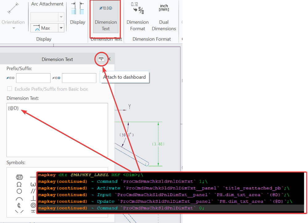

unfortunately I do not understand term Dimension text pop-out window. Please attach picture.

Here is a combined screenshot of the culprit window, as well as the mapkey that is being used to cause this routine crash.
The functionality is now such that when you call the Dimension Text Pop-Out, it forces it to disconnect. This exact same mapkey used to simply display the window, then close it (CREO 5). Now it causes the window to Pop-out, and locate somewhere random on the screen.
The crash seems to be caused not exclusively by the mapkey, but when the animation to hide the window starts. These pop-out windows come with a ridiculous animation to move them back up to the ribbon. It is during this animation, where CREO doesn't seem to want to receive any new commands; if you middle click during the animation, it will cause a crash.
ie. run the mapkey, middle click to pan the view to add another dimension, crash
The only solution I've got is to run the mapkey, then wait 10 seconds to make sure the animation clears.
Is there a way to disable these animations? This isn't a video game, why do we have this animation, and only for this one item in the whole of the software?

1.]
It seems to me that your mapkey dtr encloses @D in parentheses.
2.]
I created mapkey dtr in Creo Parametric 6.0.4.0 - see below.
mapkey dtr ~ Command `ProCmdPmaChkSldPnlDimTxt`  1;\
mapkey(continued) ~ Trail `main_dlg_cur` `Dimension_Properties:ProCmdPmaChkSldPnlDimTxt` \
mapkey(continued) `RibbonPanelsOnActivate_ProCmdPmaChkSldPnlDimTxt` ``;\
mapkey(continued) ~ Input `ProCmdPmaChkSldPnlDimTxt__panel` `PH.dim_txt_area` ``;\
mapkey(continued) ~ Input `ProCmdPmaChkSldPnlDimTxt__panel` `PH.dim_txt_area` `(`;\
mapkey(continued) ~ Input `ProCmdPmaChkSldPnlDimTxt__panel` `PH.dim_txt_area` `(@`;\
mapkey(continued) ~ Input `ProCmdPmaChkSldPnlDimTxt__panel` `PH.dim_txt_area` `(@D`;\
mapkey(continued) ~ Input `ProCmdPmaChkSldPnlDimTxt__panel` `PH.dim_txt_area` `(@D)`;\
mapkey(continued) ~ Update `ProCmdPmaChkSldPnlDimTxt__panel` `PH.dim_txt_area` `(@D)`;\
mapkey(continued) ~ Command `ProCmdPmaChkSldPnlDimTxt`  0;\
This mapkey works well - see uloaded refdim.mp4 video
  • dialog box does not contain Attach top dashboard button
  • no animation is visible
I do not understand why your Creo installation causes problems ...

As can be seen in the options dialog, PTC has already admitted that their animation algorithm is something of a wonder. Please add additional options to disable ALL the animations, because we all know that they just simply don't work; frankly, I don't want them at all.
