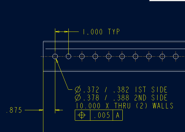

Not sure I understood correctly:
From the family table - this specific instance has 10
Does this help?

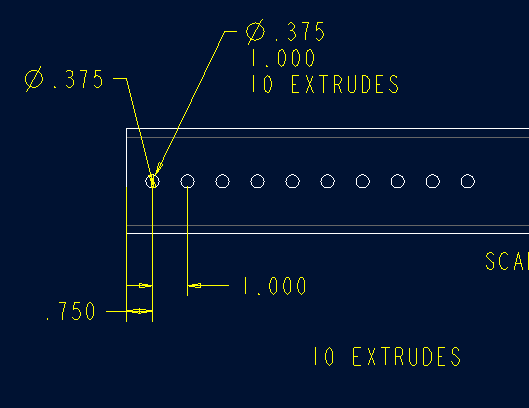

Ah, ok, I didn't know it was a family table part. I'm betting if you create a new part in Creo 4 and make a new pattern you'll see the " EXTRUDE" in the suffix box.
Are you showing dimensions, or adding them?
Top right dimension added - other four shown.
Now I see what you are talking about.
Yup! Weird, huh?
