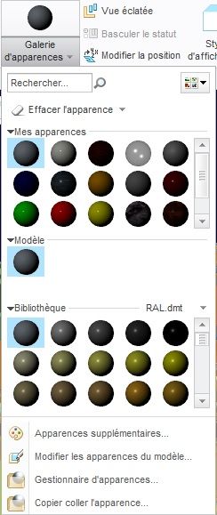

(CREO3 - M130) We have the same problem of color too dark and the menu of the render is very very slow to appear
In our config.pro we have : GRAPHICS opengl

Did you try the posted solution?
Remove the config.pro option pro_texture_library and see if that helps.
Opengl is the prefered and default graphics option and normally gives you the best performance
