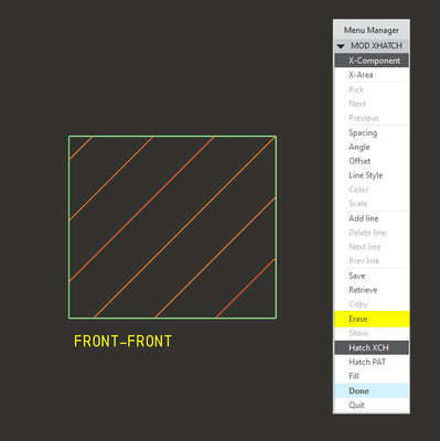

You can remove hatch following these steps:
- select Layout tab
- double click on hatch to open menu on picture below
- click on erase to remove hatch

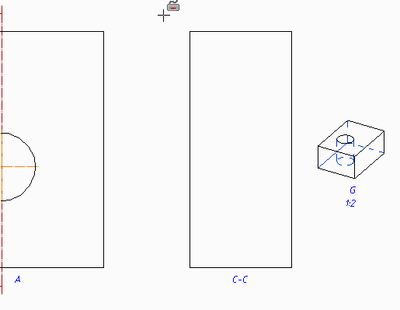

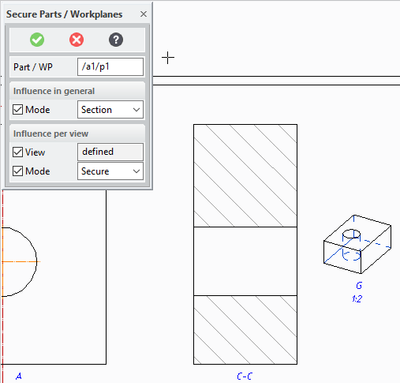

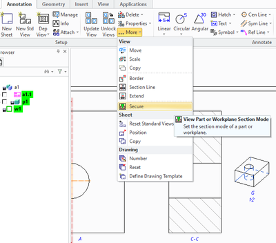

Try Secure as well:
Then update the view:
