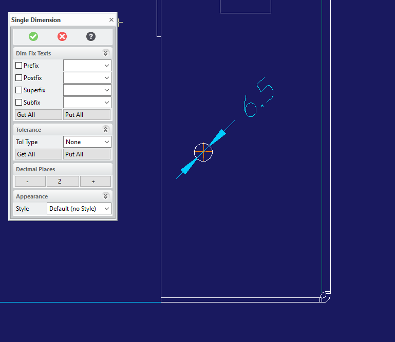

Im a solidworks user, but im starting to work with creo elements/direct.
When i try to add a dimension to a hole, the diameter symbol doesn`t show.
Can someone help me?

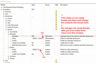

Hello
if you want that the diameter or radius dimensions that you place in the future will have the right prefix follow this
This brings you to:
Now you can try to add a Ø and a radius dimension to a hole.
Hope this helps  Success

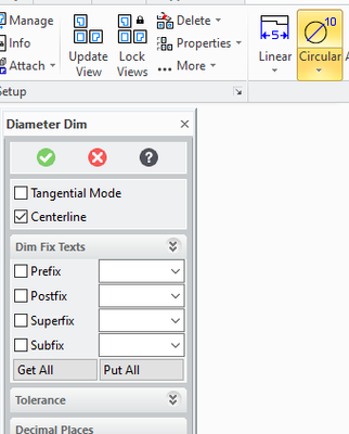

The dialog on your image "Single Dimension" is for linear dimension.
You should click on "Circular":

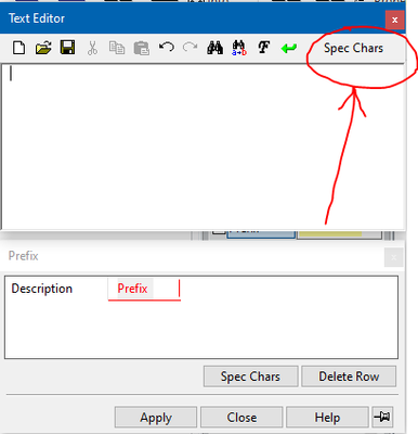

You'll get:

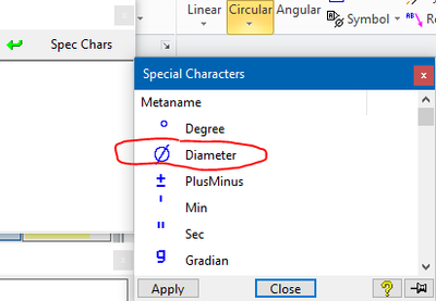

Click on "Spec Chars":

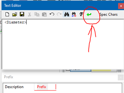

Click on "Diameter" and "Apply"
And finally, click on the green arrow.

Hello
This brings you to:
