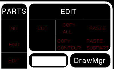

Dear Friedhelm,
Having no tablet, I can only imagine the situation. Therefore, my reply may not be adequate.
With the ME10 editor, as far as I know, there is no solution.
For other situations, I do not see the problem of using the tablet menu PASTE: you do not have to use the mouse.
