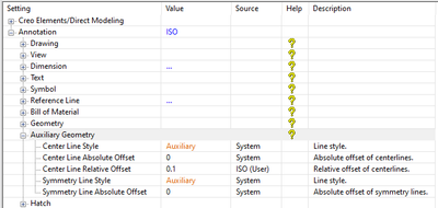

have a busy hole pattern, using Show Model Annotations I am adding the datum axes, but they are too big and overlapping. How do you change the size of when they are first added? (I know how to change them manually once they are added).
Click on File > Settings > Auxiliary Geometry,
then double click on the value to change it for new center lines:
