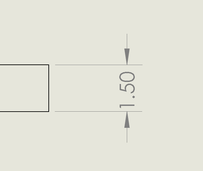

Show an example of what you are looking for.
Creo does not have this ability
vertical dimension with vertical "text" along vertical dimension lines

That dimension does not comply with the requirements of ASME Y14.5-2018, paragraph 4.4.5.2 and figure 4-16.
and this is the reason to do not have this ability to save space and make drawings look better

Whatever your preference, before clicking the position of the dimension, right click and select orientation.
For an existing dimension, edit the properties of the dimension.

don't understand how you did it
i did try to play with orientation nut its for orientation of dimension nit dimension text

Sorry, I made a mistake. To change the orientation of the text, edit the properties of the dimensions:
Text Props > Orientation > Parallel
