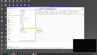

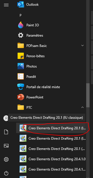

If you click on
you will get this look
Is this the look that you want?

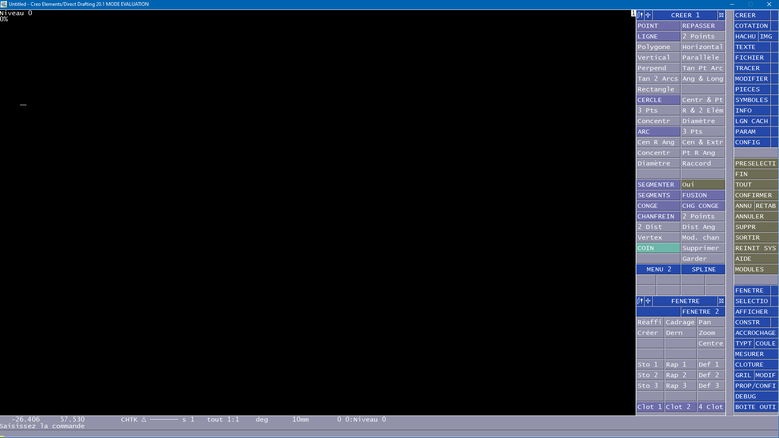

MarcoLoli
(To:Kotom-Eng)
Kotom,
thank you for your reply.
What I'm looking for the black screen (Cocreate colours).
Unfortunately, I can change the colors to the cocreate style after the start up, but I have to do everytime and the selection is not persistent.
Any clue?
