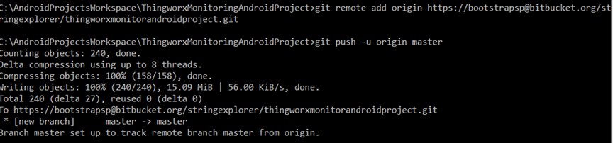

11. On your local machine open a command prompt and navigate to the drive where the local GIT's code repository resides, i.e. the folder where you unzipped the android SDK and execute the commands as mentioned:
a. git remote add origin https://<accountName@bitbucket.org>/<teamName>/<projectName>.git
b. git push -u origin master
Note: This will add the contents of your local GIT repository to the empty code repository you’ve created under the team on Bitbucket.
12. You can also use SourceTree UI application on windows for creating, GIT and Mercury based code repository and connect it to your Bitbucket account
13. On successful commit following will be logged in the command prompt
