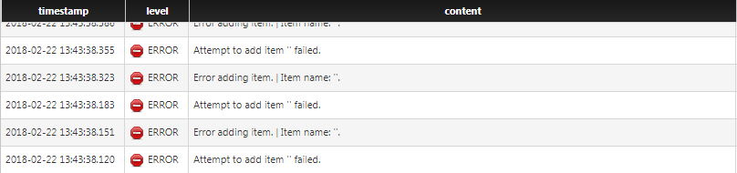

Unfortunately, my issue isn't resolved.  When the Thingworx instance or KEPServer instance is restarted, the bindings to my RemoteKEPServerEXThing get messed up.  I get errors as shown below.  They come in pairs and they show up the exact number of properties that I have attached to my KEPServer Thing.  It looks like it's attempting to add a null item.  I'm not sure where the null reference is being kept, so I don't know how to get rid of it.  Any ideas?
I am able to run AddItems service on the KEPServer Thing again with the same tags, but I don't want to have to do this every time the server gets restarted.  Error capture add items fail.PNG
Thank you for the post.
Just to confirm you have ThingWorx 7.1, and you are running KEPServerEX, 6.4, using the legacy mode for the ThingWorx native interface found in the project properties in the KEPServerEX. Also, you are able to get data through the system, but when you restart you see errors such as {attempt to add item" "] in both the ThingWorx and KEPServerEX logs?
Would you be able to upload your KEPServerEX event log as a text file?

Thingworx 7.1 and KEPServerEX 6.2.
It turns out it had something to do with using $ symbols in the Name or Source field.  Although Thingworx and KEPServer both allow using $ in Property names or Channel, Device, Tag names, the $ seems to be a delimiter in KEPServer's interfacing with Thingworx.
Once we changed all the $'s in our tags, they rebound correctly upon a restart.
It was odd that error checking didn't seem to be performed in AddItems to let you know that restricted characters were given as input.
