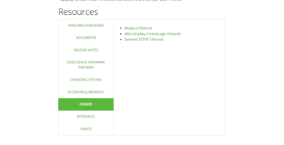

The ThingWorx Kepware Edge(TKE) does not have advanced tag plug-in.
For what TKE provides please take reference to this page:
https://www.kepware.com/en-us/products/thingworx-kepware-edge/
Thanks!
