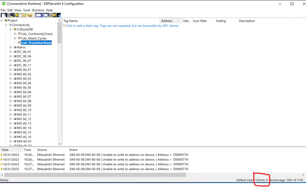

Thank you! I'll be sure to give it a try.  Quick question though, I seem to not have any active clients according to the bottom right corner. Just wondering what's up with that.
@White_Chedda_
Having zero clients connected and active tags showing is an indication that an KEPServerEX Advanced Plug-In has been configured. Some Advanced Plug-In examples are Advanced Tags. Alarms & Events, Datalogger or IoT Gateway.
*Chris
Okay, so if I stop the usage of my advanced tags and data loggers, then that should free it up to auto-collect.  I'll try that too, but either way, you're copy and paste method worked as well.  Thank you for all the clarification and help!
