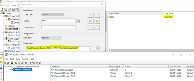

I'm trying to use a Derived tag to compare a string tag to some static strings and return boolean response for if it matches or not. I was hoping the logic operator == would do this like it does for numerical values but expression validation returns "String tag expected". Is there another logic operator to use to compare string values or do I have to do something different?
Using KepServerEX 6.14
Thanks!

It actually does work for String comparison. Please see the example below:
Then writing the same value to String2 evaluates correctly:

Thanks to both of you for the responses!
