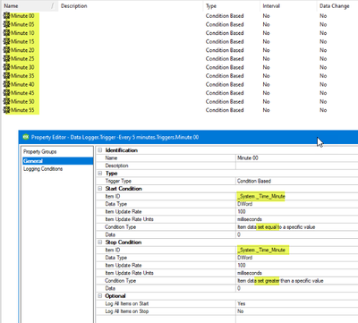

This might be easier. First one sets up the triggers and the second one uses them. Only logs one time per rising transition

I have a working one that is
(General Tab)
"Always Triggered"
(Logging Options)
Log on Static Interval = No
Log on Data Change = Yes
(Monitor Item)
Log All items = No
But its always on - I'm not turning it off and on via anything else, I removed the data I don't want via the SQL query later on in the process
Having said that, I do have a logging group called Triggers that are time based (every 5 minutes by the clock) and I use that group as a trigger for other groups because oddly enough the Start and Stop use the moment the log groups starts logging as the base for timing and not the minutes of the clock..
So essentially nesting triggers got me where I needed to be
