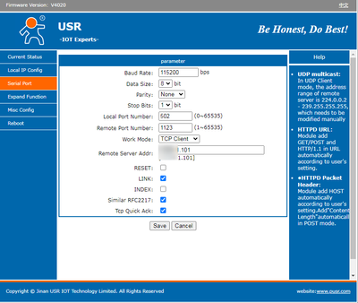

- USR-TCP232-304 Module: Converts RS-485 communication from PLCs to Ethernet for Kepware to access. (Link to user manual: https://www.pusr.com/download/M0/USR-TCP232-304-User-Manual_V1.0.3.01.pdf)

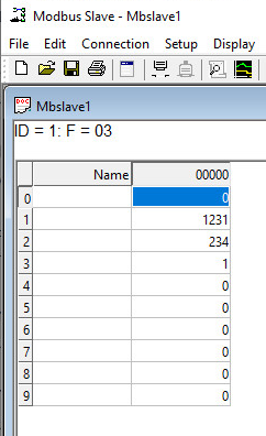

I can successfully receive data using a "Modbus slave" emulator software.

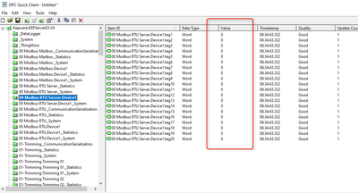

However, Kepware OPC Server fails to receive data from the PLCs.

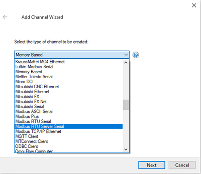

Driver: Modbus RTU Server Serial

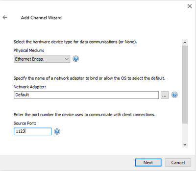

Physical Medium: Ethernet Encap.
Port: 1123

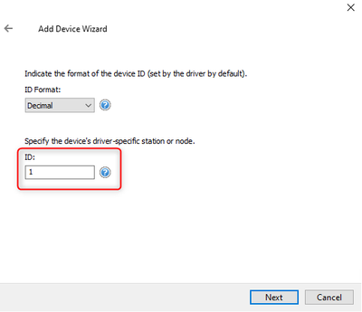

Device 1: ID 1 (matching PLC master write address)
What I Need Help With:
Can someone advise on the correct Kepware driver for my setup?
Are there any additional configuration steps required for Kepware or the USR module to establish communication?
Any troubleshooting tips for Kepware's diagnostic tools to identify specific issues?
