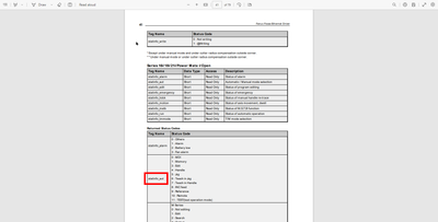

Is there a list of Fanuc Focas CNC status addresses
Please refer page 39 of Fanuc Focas Ethernet Driver manual.
Hope this answers your questions, if not let me know and I will do my best to help you.

Yes.  I am looking for standard address when setting up mode, state, etc.
Raj Shekhar Kumar
MM_10545292
6-Contributor
(To:rajskumar)
Do I just post the below in red box     in the address column of the tag?
AKshara
(To:MM_10545292)
Yes, when defining the tag in the channel, the tag name that was provided in the address field has to be included.
