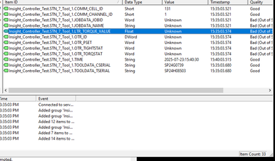

I have a similar issue but I am communicating with the device because I am getting other values, but not LTR  -
I can't get data in any of these tags. I initiated an asynchronous read and didn't get any data back.
Posting here for the wider community,
Based on internal findings, it was a port issue, and after configuring the correct port in Kepserver, it started working fine. Closing this community post as solved. Thanks
