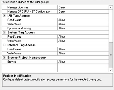

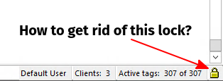

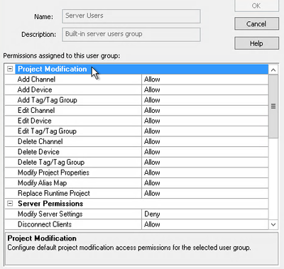

My runtime configuration is locked. I cannot find information in the manual about this condition or how to remove it. Does anyone know how to remove this lock?
Solved! Go to Solution.
Take a look - "Configuration not launching in v6.12 of PTC Kepware Products": https://www.ptc.com/en/support/article/CS373678
