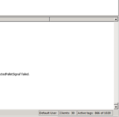

Dear Experts,
We have currently using Kepware V5.20.396.0 and V6.1 on two different platforms, we have plenty number of clients connected to these servers, we are looking to see clients IP addresses to manage access and load on server. Can anyone guide from where I can find it. I have attached snapshot below.
Shabir
Hi Shabir,
What type of Clients are connecting? (If you are not sure you can check the interfaces enabled in KEPServerEX to at least rule some interfaces out). To see OPC UA Clients connecting you would launch Wireshark and filter down the protocol to 'OPC UA' and see the source IPs.
