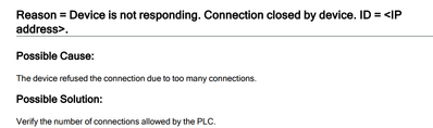

We are working with PLC Siemens S7-1500 Firmware v4.0. OPC is able to establish connection but at some point it disconnects and gives following error: "Device is not responding. Connection closed by device". Slot and rack in configurtion is correct.
KEPServerEX version 6.18
Could you please suggest any solution?

Assuming you're using the Siemens S7 Plus Ethernet Driver — in version 6.18, we added support for S7-1500 devices with firmware version 4.0, so you should be covered in that regard.
I reviewed the manual, and based on the information provided:
  • Possible Cause: The device refused the connection due to too many connections.
  • Suggested Solution: Verify the number of connections allowed by the PLC.
Kindly check this configuration and see if it resolves the issue. If the problem persists, capturing a Wireshark trace may help us understand what’s happening at the packet level.
