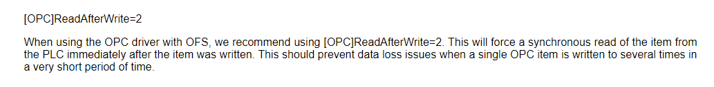

I'm still surprised by this. However, I discovered a Citect OPC parameter that goes in the OPC section of the Citect ini file - "ReadAfterWrite" - and this solves it.
You suggestion pointed me to look for this so thank-you again!
Kepware itself acts as middleware and cannot directly perform read/write(A client is needed) operations and send them to the Citect DA client. Instead, the Citect DA client must perform a read after write to determine the final value (in this case, 0).
Regarding the Quick Client, it is important to note that it has a default update rate of 1000 ms. If the scan mode in the Kepware driver is set to “Respect Client specified Scan rate,” the Quick Client will read after each 1000 ms and update the value.
For further troubleshooting, I recommend trying a Sync/Async read in the Citect client to observe whether it updates the value to 0.
