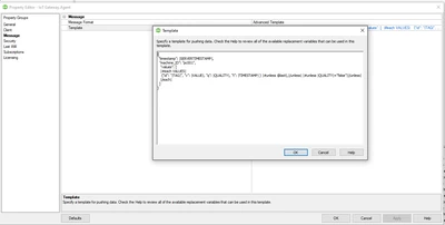

I am using Iot-gateway in Kepware, and I want to only send messages if they have quality set to true. I tried to use Advanced templates, but I could not find any guide anywhere on how to use the directives there. I tried this, but got an error.
"timestamp": |SERVERTIMESTAMP|,
"machine_ID": "m_id1",
"values": [
|#each VALUES|
{"id": "|TAG|", "v": |VALUE|, "q": |QUALITY|, "t": |TIMESTAMP| } |#unless @last|,|/unless| |#unless |QUALITY|="false"||/unless|
|/each|

The closest setting we have is “ignore quality changes”. That should allow you to receive only value changes. What you specifically requested is not supported.

I tried some way to use them if-else. Please try if possible with the help of unless.
My problem statement :
I want to display the timestamp and description only once. so I developed this template and it is working as per expectation.
Please check if you can use something like this.
"values":
{|#each VALUES||#unless @first||else||LINEFEED|"t": |TIMESTAMP|,|LINEFEED|"id":"|DESCRIPTION|",|LINEFEED||/unless|"|TAG|": |VALUE|,|LINEFEED||/each|
