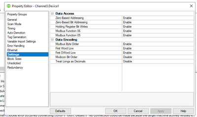

Hello everyone,
I have a PLC Tag with a 32-bit float address (400188). When I read this using simple Modbus, I obtain a value of 15104753. However, when I configure the same in Kepware, using the float data type with the same address, I see a value of 15116893. I have tried various configurations, but the values still do not match. Please refer to the device settings and suggest a solution for the issue.
Thank you!

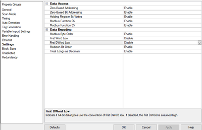

You can try the settings listed below and share your results.
Best Regards,
Bhadresh Rangi
