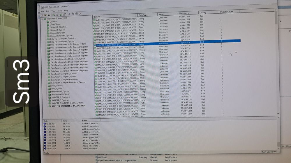

thank you for your answer.
I have configured DCOM, but there is still a problem where the server tag can be imported into kepware but on the quick client, all values ​​are "unknown". Screenshot_8.pngScreenshot_9.png
a notification like this appears.
I've followed the way to solve this problem on PTC kepware, but it still doesn't work

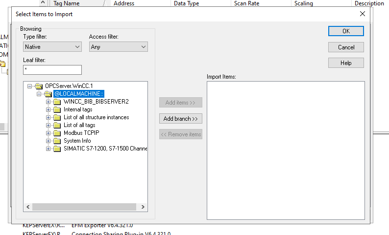

Can u provide an update?  I'm having the same issue.  I'm able for Kepware to import the Wincc OPCDA server tags, but the kepware OPC DA Client is unable to read the values.  OPC Quick Clint is able to read the Wincc OPC DA server with no issues.
Matt

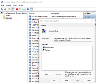

Previously the problem was because the user did not have access,
to solve it, I created the same user and pass on each device and added them to the group Administrators, and followed the DCOM settings again

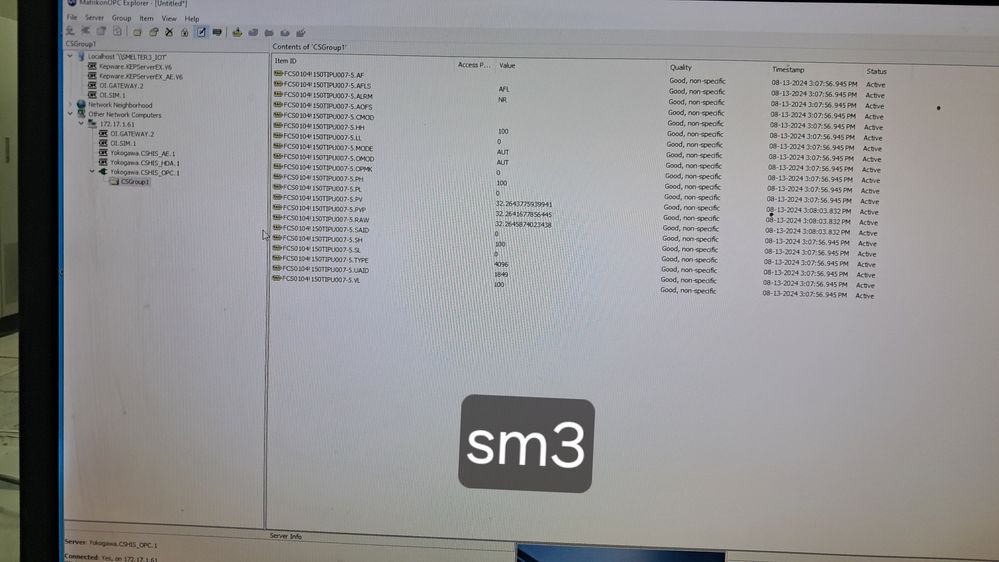

Hi after this Again DCOM setting still i am facing bad values of remote opc da server into MY kepware any other setting require for it?
In matrikon showing me good data values but in kepware all values are showing bad ( bad var type) please suggest me for aany require setting of it
