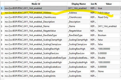

When i browse the tags through Matrikon OPC UA explorer, The tag displays all the attributes along with the value. is there any way we can suppress them.

I wanted to share a quick note regarding tag browsing behavior in Matrikon OPC UA Explorer when connected to KEPServerEX. Currently, KEPServerEX does not support suppressing the additional attributes (such as _address, _timestamp, etc.) that appear alongside tag values during OPC UA browsing.
If you're looking to streamline the tag view or suppress these attributes, I would suggest coordinating directly with Matrikon to explore any client-side filtering options they may offer.
